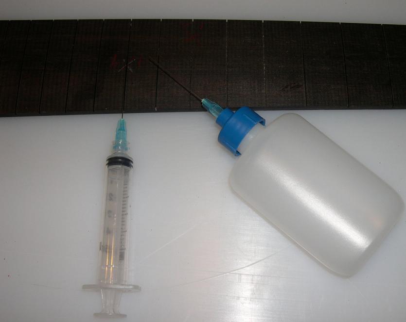

Though I haven't glue in frets, if you're in the Toronto area URL=http://www.theplasticstore.com/menusystem/]Warehoused Plastic Sales Inc[/URL] have the hypodermic needles with very fine metal points which would do the job. They'll ship if needed.

Here's the needle and other glue bottle they offer. The needle fits the fret slot easily and in the image is in the slot about 1-1/2 inches.

As a Doc, the 27g needle is very small. The pict above is light blue so it is
typically a 25g needle. I would think most drug stores would sell them
without the need for a prescription.

[QUOTE=azimmer1]As a Doc, the 27g needle is very small. The pict above is light blue so it is
typically a 25g needle. I would think most drug stores would sell them without the need for a prescription.
A doctor in the house...this forums got everything!
Yes I bought a 27 gauge syringe today (30 cents at the drug store) and it fits nicely. A 25 gauge would problably just barely fit.
